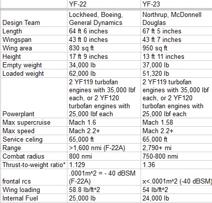

у програмы ATF вот что было заложено как фундамент...
"1984 The USAF HQ approved an ATF Statement of Operational Need (SON). The ATF requirement was refined and clarified. The core of this requirement was to achieve unprecedented levels of sustained cruise speed using economical fuel burn, and a reduction in the detectability of the aircraft by radar compared to previous fighters. The USAF had covertly conducted several research programmes into the feasibility of stealth and had fielded a practical strike aircraft, the F-117, so it was confident that this technology could be applied to a high performance fighter. It was assumed at the time that the new fighter would be compelled to operate from bomb damaged runways and would need the ability to take off and land in a distance considerably less than the full length. There was the intent to curb the escalating cost of fighter procurement was well. The SON called for a 5th Generation fighter with the following parameters:
In Flight Performance:
a combat radius of approx 800 miles
supersonic cruise, including:
the ability to cruise at Mach 1.4-1.5 when in hostile territory
the ability to accelerate from Mach 0.6 to Mach 1 in 20 seconds
the ability to accelerate from Mach 0.8 to Mach 1.8 in 50 seconds at 20-30,000 ft
supersonic manoevure, including:
2 g turn sustained at Mach 1.5 and 50,000 ft
5 g turn at Mach 1
6 g turn at Mach 1.5 and 30,000 ft,
9 g turn at Mach 0.9 and 10,000 ft for 30 secs
In Logistics:
the ability operate from 2,000 ft of runway
compatibility with existing infrastructure including HAS
the ability to carry existing air to air weapons
to have double the F-15 sortie rate , halved turnaround time to 15 minutes, and ability to fix 75% of faults in 4 hours
(At the time, the USAF employed maintenance staff trained in about 25 specialised tasks. The goal for the ATF was 8-10 specializations. There was also to be a simplification from a 3-level maintenance system to 2-level.)
to have modular reconfigurable avionics
a gross take-off weight of 50,000lbs
In Economics:
Individual aircraft price capped to $40 million in 1985 dollars based on a production run of 750 aircraft
Total Life Cycle Cost comparable to the F-15
A total programme cost of $65 billion.
In addition:
Avionics were to be integrated to a higher level than previous generation fighters, fused sensor data was to be displayed to the pilot, thrust reversers were to be employed to augment in flight manoevurability and to facilitate the runway requirement, and it had to have a dramatically reduced radar signature compared to 4th generation fighters. Most performance parameters were expressed in 'required' and 'desired' values, but were matched with a cost ceiling which ruled out any attempt to achieve 'desired' values in all categories at once...."
где есть сериозный компромис с какой нибудь характеристике тактического изстребителя?
Добавлено спустя 18 минут 2 секунды:
совсем другой вопрос, удоволетворил ли продукт требований USAF
блогери из США упорно на етой информации ссылаются
http://1.bp.blogspot.com/-MhV1Vj94xQM/T ... BYF-23.jpg
Добавлено спустя 5 минут 6 секунд:
боллее подробно - здесь: http://www.panzertruppen.org/suscripcion/f22.pdf
